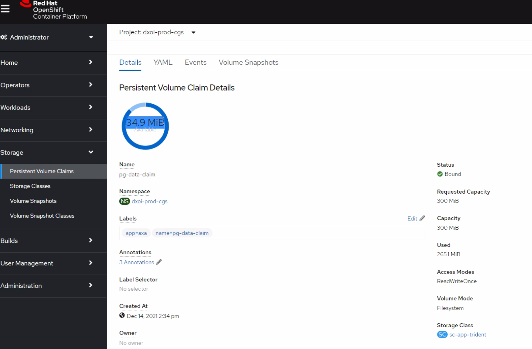

DX Platform 2x
Insufficient allocated disk space
pg-data-clamp pvc had been manually reconfigured and reduced from 1GB to 300MB and only 34Mb was available.
Increase capacity to the pg-data-clamp PVC
