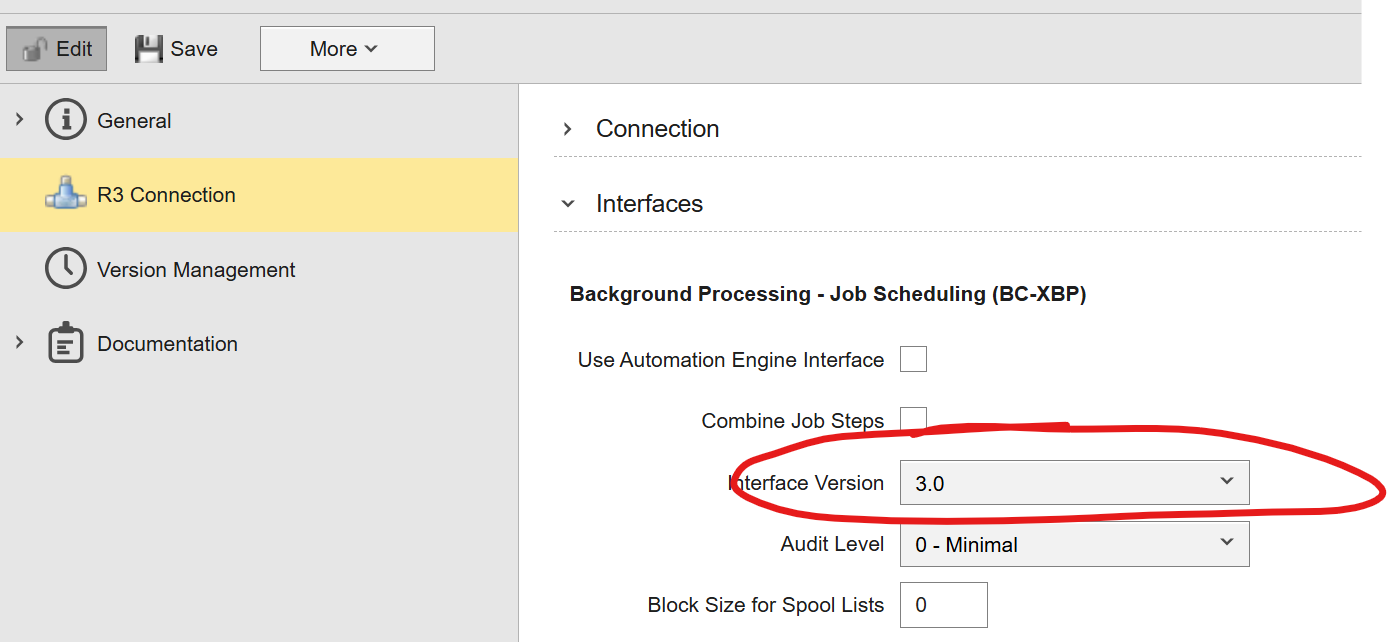

The XBP interface used by the SAP agent is not set up to use XBP 3.0 which is required in order to use all SAP functions.  A Basis admin should know how to set this up within SAP.
In addition, the agent's connection object must also have Interface Version 3.0 chosen from the Interfaces dropdown and the Use Automation Engine Interface must be unchecked:\
