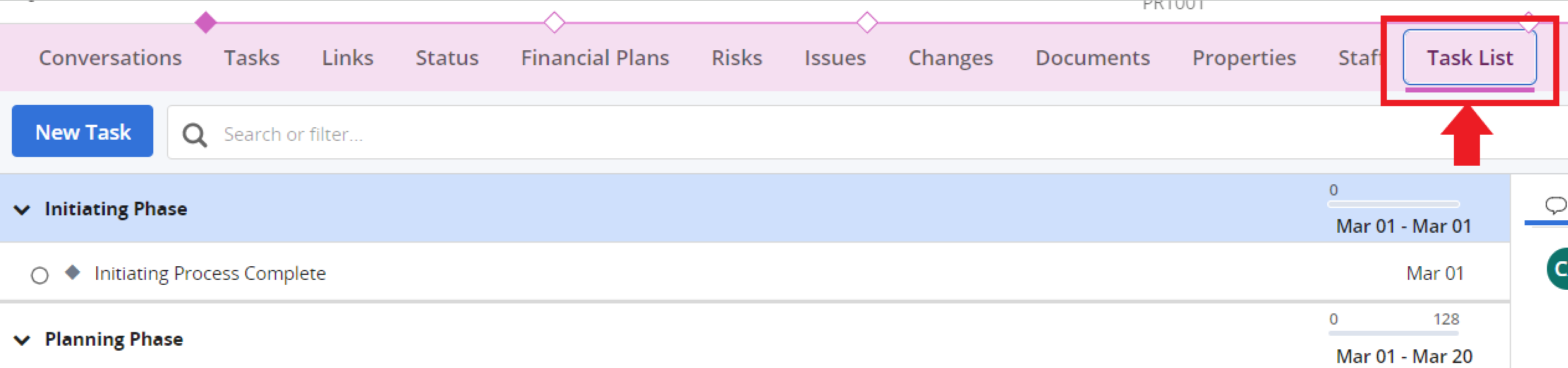

These known issues apply to the 2-level 'TASK LIST' Module. (This module is highlighted in red below)
