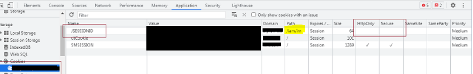

It was observed that the HTTPOnly and Secure attributes are set to no in the session cookie of the application.

Screenshot
