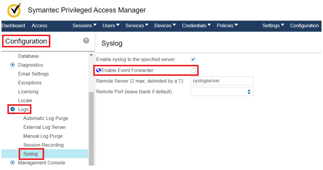

  • PAM 4.0 and 4.0.1 Utility Server (One PAM enabled):
    • PAM 4.0 includes a new appliance type called a Utility Appliance, which requires a patch if the event forwarder component within the Utility Appliance is enabled.
    • The PAM 4.0 and 4.0.1 Event Forwarder patch addresses both CVE-2021-44228 & CVE-2021-45046.
    • If the event forwarder is disabled/unchecked, there is no need to patch it. This is the default setting.
    • To verify if it is enabled, go into PAM UI >> Configuration >> Logs >> Syslog:
    • If the "Enable Event Forwarder" option is checked, or you intend to check/enable it in the future, see the following documentation for patch links and installation instructions:
