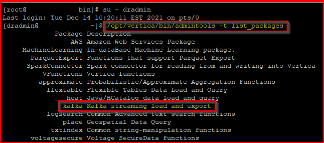

      If
      you re-run the same syntax, you will get a message that the Kafka package is not currently installed:
      Note that the kafka package is still displayed in the following syntax:
      $ /opt/vertica/bin/admintools -t list_packages
    • If dbpassword has a special character, escape it by surrounding the password with single quotes.

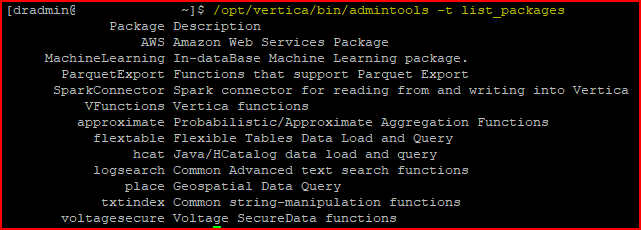

  3. Log into each Vertica node as root, and run this command:
    • rm -rf /opt/vertica/packages/kafka
      After removing the kafka files, it is no longer displayed in the following syntax:
  4. No need to restart Vertica.
