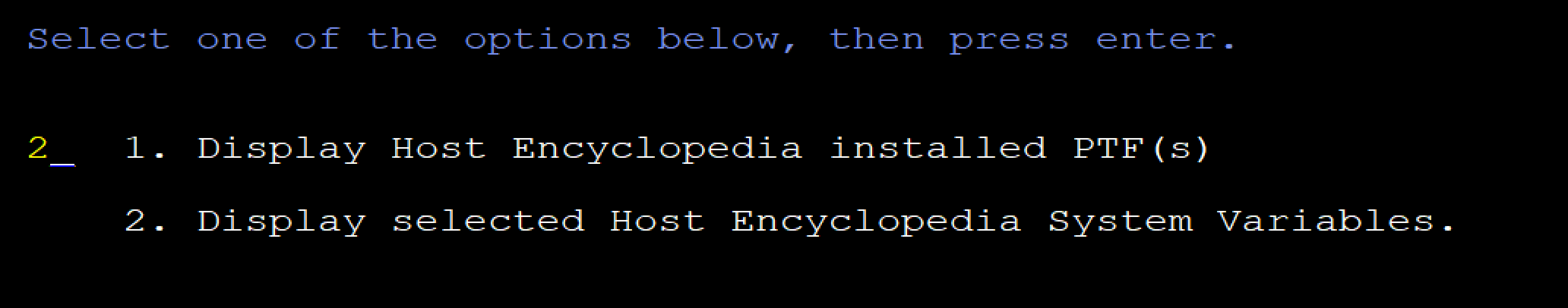

To be able to get the existing Encyclopedia ID for a specific Host Encyclopedia in order to ensure unique IDs are used, please go under options 5
then option 5 again:
then option 2 from the Main Panel.

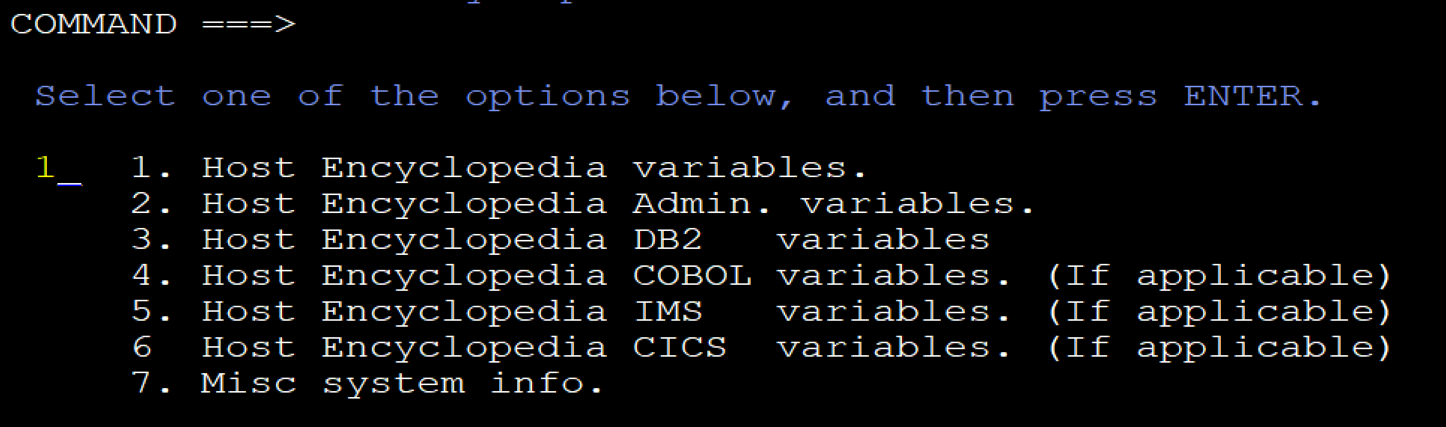

Then please select option 1:
The above will then take you to the screen to confirm your Host Encyclopedia variables, including your Encyclopedia ID.
This number must be unique between 1 - 9999 (can add more).  Type the numeric ID of the host encyclopedia (Range 1 - 9999).  If you have several encyclopedias at your site, each must have a unique ID in order to communicate with other host and client server encyclopedias.
