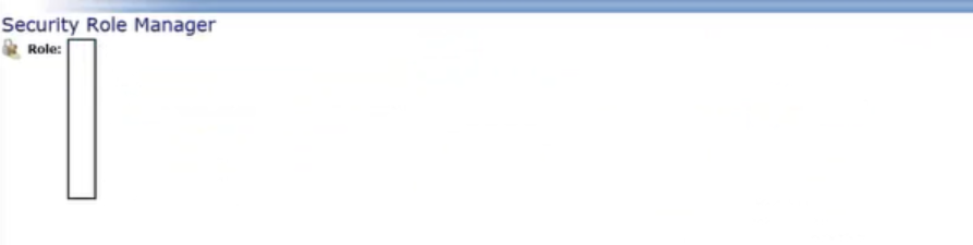

If going to Settings>Security only the "Security Role Manager" option is seen. When opening Security Role Manager, under the "Role" dropdown list, it comes back blank.

The problem was not permissions. It was because some objects were set to "ProductUninstalled" to 1 in the database. So, since there was nothing to return as far as data goes (because they were set to uninstalled), the SMP Console page/frame was considering that if there was no data then it is because maybe it does not have rights to read it.
When we fail in an upgrade, there are some internal procedures that go through these objects in the database and uninstall the pieces that failed on install/update. Since there were so many repairs and attempts to upgrade made it was very likely that we removed more than we should have due to this unique situation.
