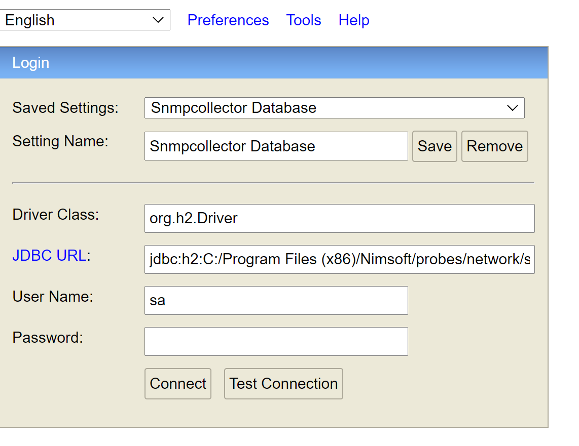

SNMPcollector maintains its own DB.
You can access this DB
going to:
http://<snmpcollector_ip>:9715/database
The first screen is an authentication page with several parameters.  Just click "Connect" without changing anything.
**This is a relational database and we strongly discourage changing values here unless specifically instructed to do so by Support.**
