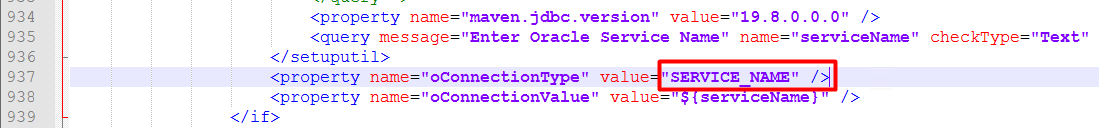

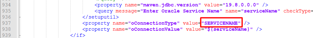

  2. Edit install.xml file and modify "oConnectionType" from "SERVICENAME" to "SERVICE_NAME" on line 937
    Before
    After

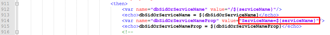

  3. Edit file setup.xml under buildomatic/bin folder. Modify "dbSidOrServiceNameProp" from "ServiceName=${serviceName}" to "SERVICE_NAME=${serviceName}" on Line 914
Before
After
