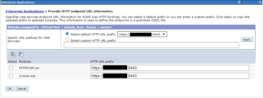

When the Custom Web Service executes it calls the Default EJB Web Service to access the EJB and the Host & Port values are also used for that purpose. This is not a security issue because it is just the internal call from the Custom Web Service to the Default EJB Web Service. Also, an Application Server normally allows web service endpoint URL configuration to enable the use of a secure port for the external access to either Custom Web Service or Default EJB Web Service. For example using WebSphere under the "Application" > "Web Services Properties" > "Provide HTTP endpoint URL information":
The Default EJB Web Service (PSTEP1SM.jar) and Custom Web Service (lynnws.war) are both visible because they are assembled together due to the dependency of the Custom Web Service on the Default EJB Web Service.
