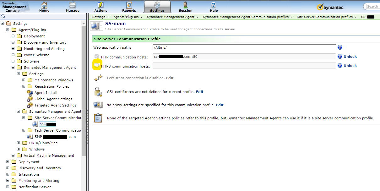

Check that you don't have "Configure HTTPs binding" under the "Global Site Server Settings" page.
As well, check that the Site Server Communication Profile was not set to HTTPS.
