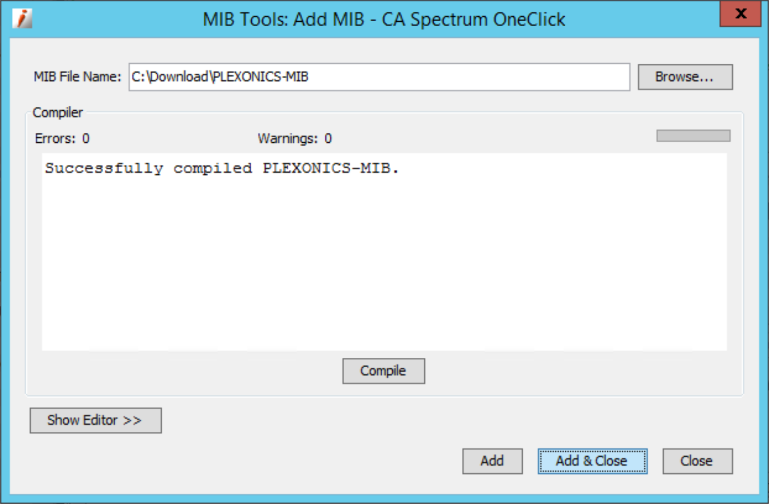

1. Compile/import the device's manufacturer's MIB file via the CA Spectrum MIB-Tools.

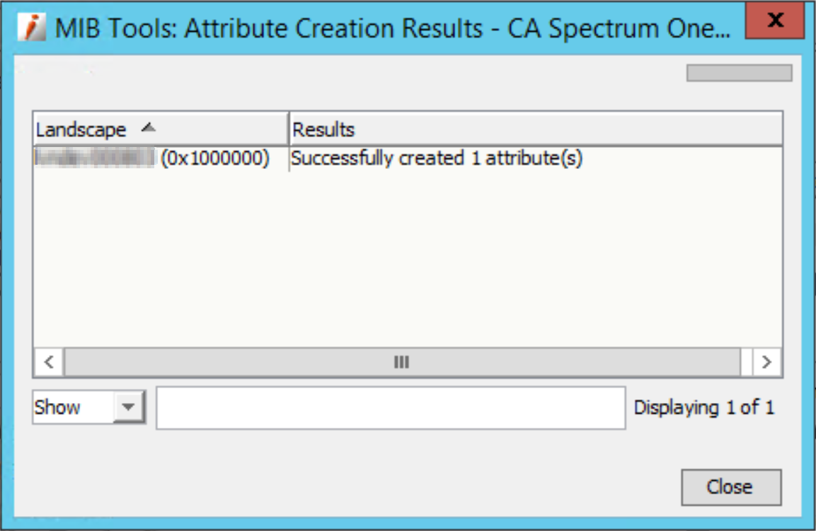

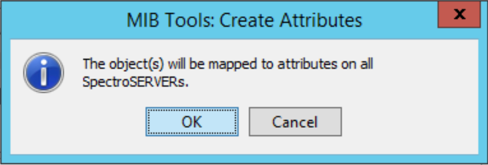

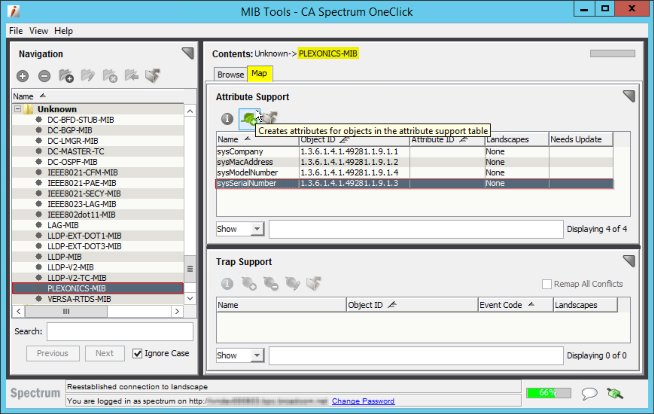

2. Map the OID where the serial number is located to a custom attribute.

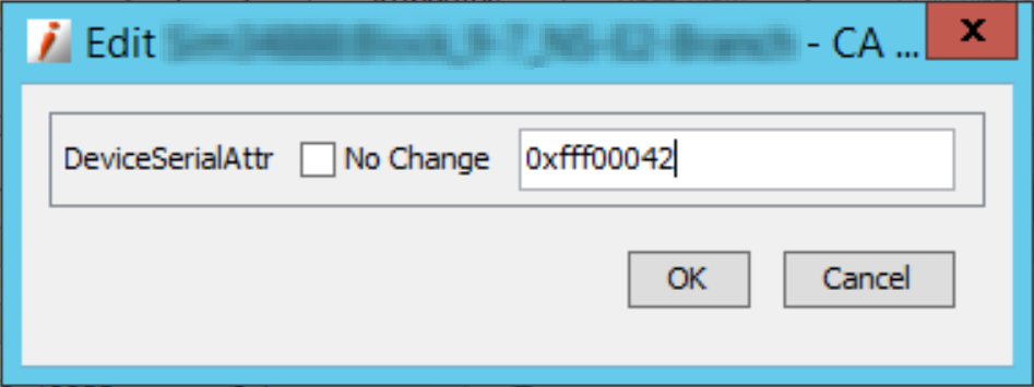

4. Take note of sysSerialNumber attribute ID and edit the DeviceSerialAttr (0x3d0063) attribute ID on the right hand side:
In my example, the sysSerialNumber attribute ID is 0xfff00042. You may have a different ID because this is a random value.
5. Supply with yours sysSerialNumber attribute ID (the 0xfff00042 is just an example - you may have a different value).

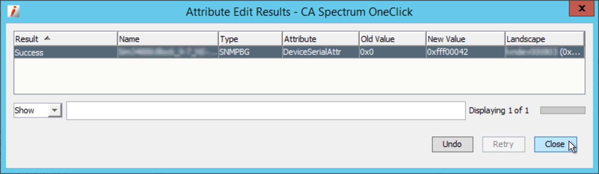

6. Click on Close to save the change.
7. Note that the value of DeviceSerialAttr (0x3d0063) attribute must match with the sysSerialNumber attribute ID.
