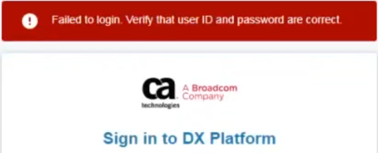

Unable to login to DX UI
“Failed to login. Verify that user ID and password are correct”

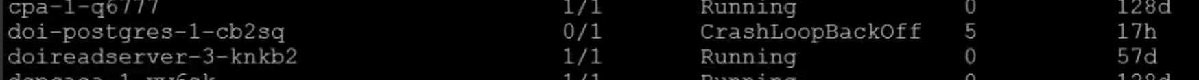

Use-case #1 - postgres pod is in "CrashLoopBackOff"
Postgres pod is not running and you cannot ssh the pod:
kubectl get pods | grep postgres

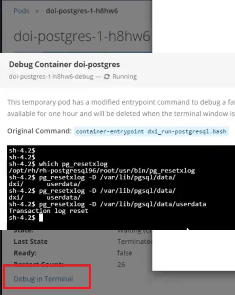

Reset PostgreSQL Transaction Logs (Xlogs) :
This will allow to clean up the transaction log as it is prevents posgres to startup, resetting the transaction log may allow PostgreSQL to start again.
1. Go to Openshift Console | Applications | pods
2. Open posgres pod
3. Click "Debug in Terminal" as illustrated below
4. Enter:
which pg_resetxlog
pg_resetxlog -D /var/lib/pgsql/data/userdata

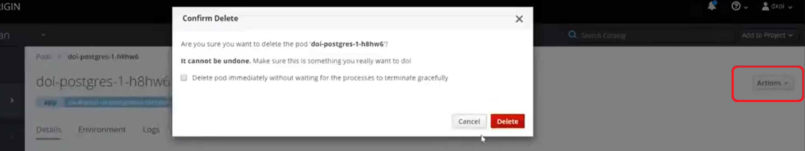

5. delete the pod so a new one is created
Click Actions > Delete

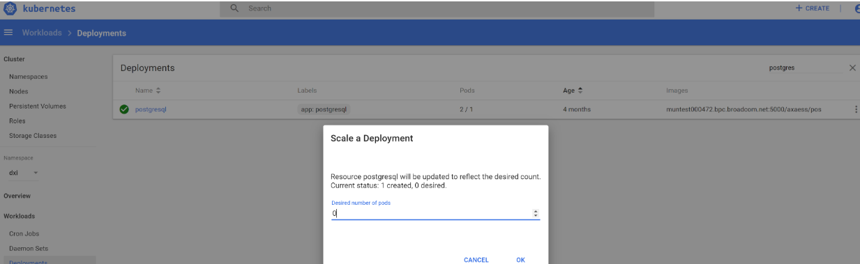

b) Scale down to zero the postgresql deployment
kubectl scale deploy postgresql --replicas=0 -ndxi
Or using Kubernetes Console
