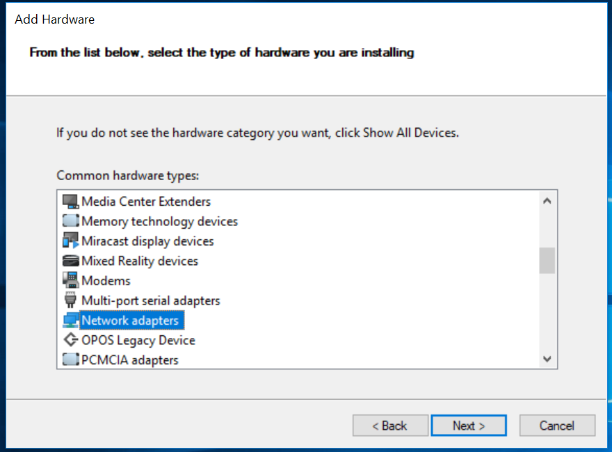

    Select Install the hardware that I manually select from a list and click Next.
  • Now you'll see:
    Select the entry Network adapters and click Next.

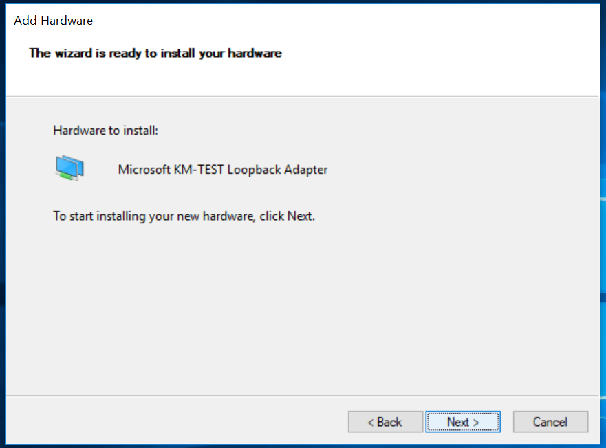

  • Almost finished:
    This is your last chance to abort, otherwise, click Next.

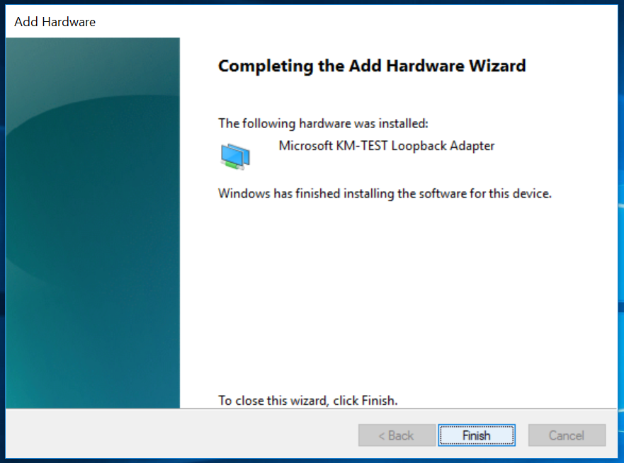

  • After a while you should see:
    Click Finish to exit the Hardware Wizard.

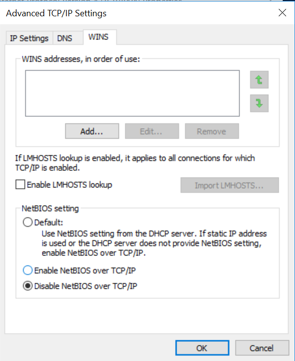

  • Click on the WINS tab:
    and select Disable NetBIOS over TCP/IP.
  • Click on OK.
