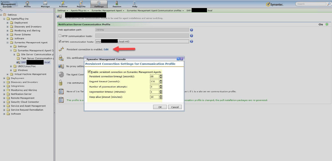

1) First, using the Symantec Management Console, go to the "Notification Server Settings", enable "Persistent Connection" and then "Save changes".
2) Second, go to Settings>All Settings>Agents/Plug-ins>Symantec Management Agent>Symantec Management Agent Communication Profiles and choose the Notification Server.
Click the "Edit" link to the right of "Persistent connection..." and the "Persistent Connection Settings for Communication Profile" dialog box appears.
Check the box to "
3) Third, go to Settings>Notification Server>Site Server Settings>Site Server Settings and click on "Global Site Server Settings". Then enable "Persistent Connection" and "Save changes".
