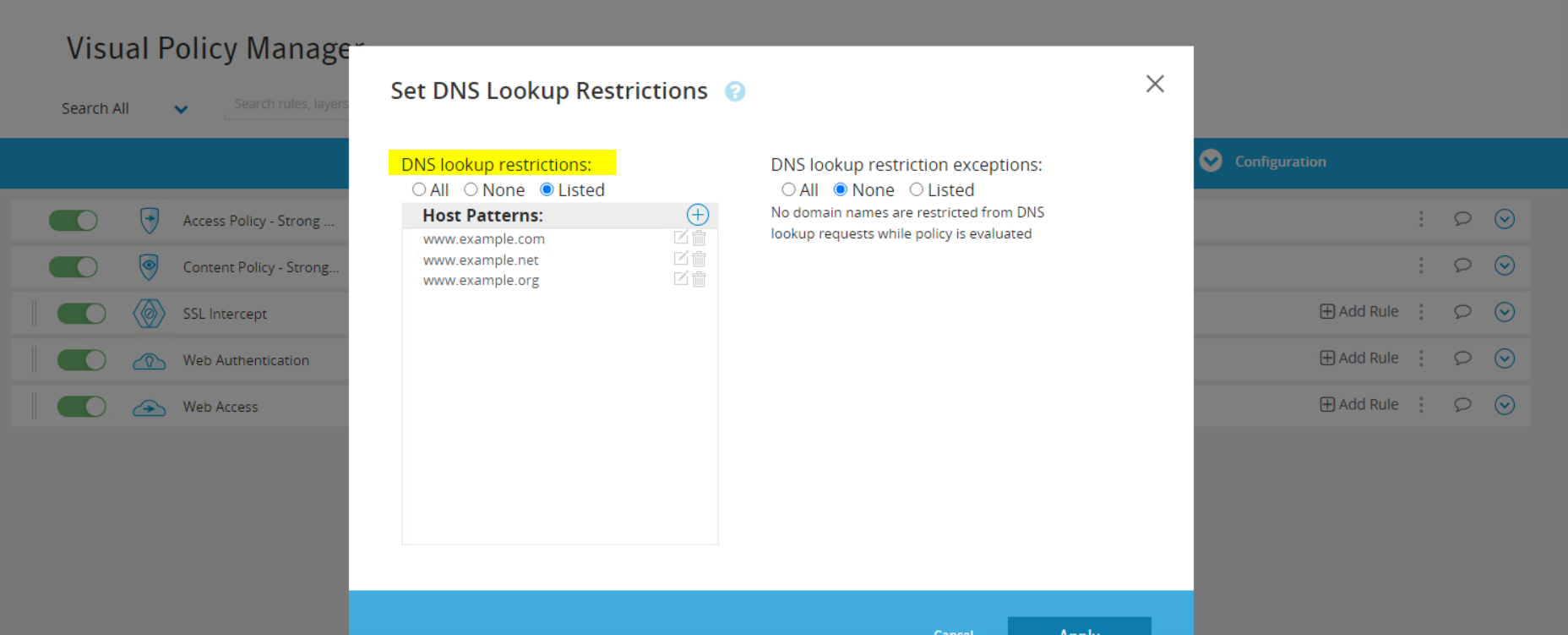

  • Access the Management Console
  • Go to Configuration > Policy > VPM (Visual Policy Manager) > Configuration > DNS Lookup Restrictions
  • Click on "Listed host patterns"
  • Add and type in the name of the domain that's having issues as shown below:
