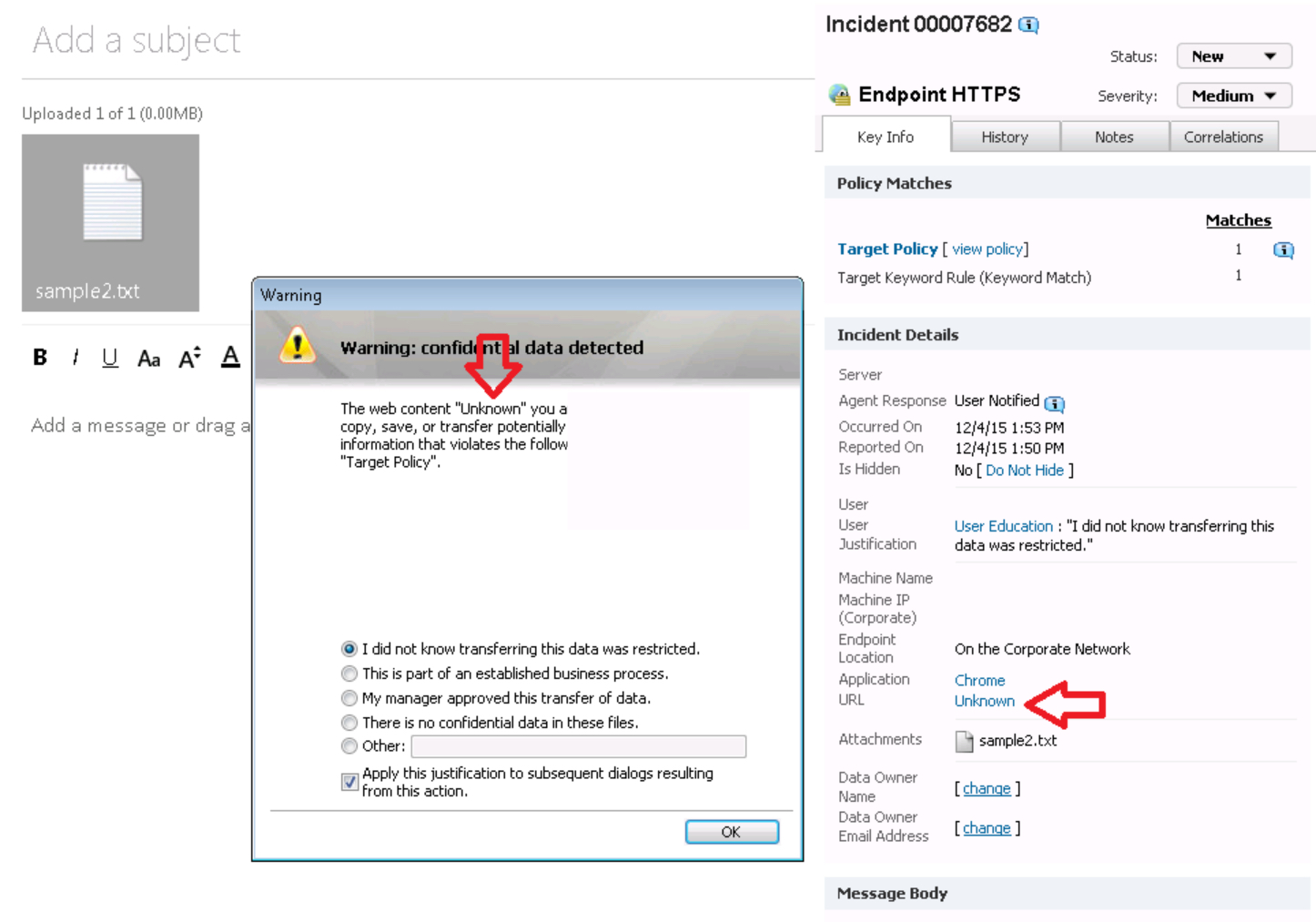

A user notification dialog and/or incident in Data Loss Prevention (DLP) Endpoint Prevent displays the URL as 'Unknown' for incidents generated by the Chrome HTTPS or Edge HTTPS (Chromium Only) monitor.
  • The web content "Unknown" you are attempting to move, copy, save, or transfer potentially contains sensitive information that violates the following security policies.
  • URL: Unknown.
