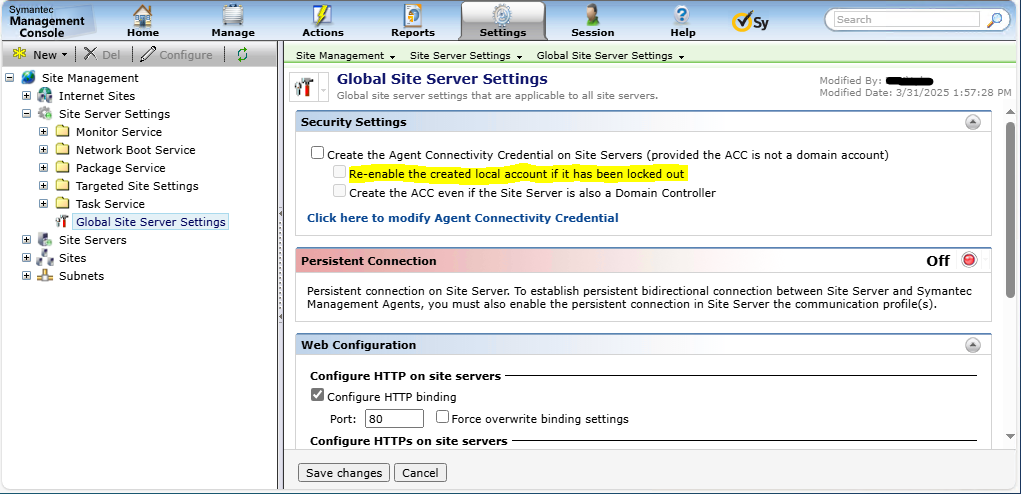

 The customer is using a Local account for ACC (Agent Connectivity Credential). He has enable "Create the Agent Connectivity Credential on Site Servers" and "re-enable the created local account if it has been locked out" in "Global Site Server Settings>Security Settings" (under Settings>Notification Server>Site Server Settings>Task Service)

Account enablement is done by the Symantec Management Agent (SMA). The Symantec Management Platform (SMP) as Site Server gets the same settings that must trigger this unlock process.
The SMA has the functionality to manage and unlock local ACC accounts if it is a Site Server and appropriate policy exist.
