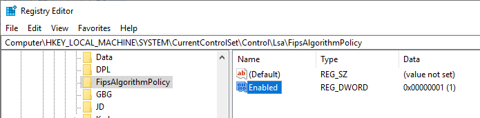

Windows 10 and Windows Server 2012 and newer will have this registry key enabled:
HKEY_LOCAL_MACHINE\SYSTEM\CurrentControlSet\Control\Lsa\FipsAlgorithmPolicy "Enabled"=dword:00000001
The ATP and SEDR appliances are not FIPS compliant under any software version. SEP Clients on FIPS-mode-enabled Windows will not be able to Enroll in the appliances for the ECC 2.0 feature.

Disable FIPS mode.
Registry Path: HKEY_LOCAL_MACHINE\SYSTEM\CurrentControlSet\Control\Lsa\FipsAlgorithmPolicy
Change Enabled value to 0.
