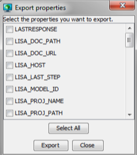

4. Still in the Properties tab, at the bottom of the ITR, scroll to the right to find the arrow icon "Export the value of these properties from runtime to design time" and select it.
The "Select Properties" window will open:
5. Select "Select All" option and "Export".
6. The message "This will save the selected properties into the design time. Do you also want ".rsp" selected properties to be saved as the step responses?" Select "Yes".
