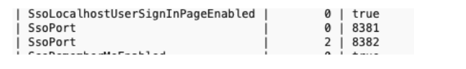

From the NFA_SSO.txt file in the RemoteEngineer can see the SsoSchme is set to https and SsoPort to 8382 instead of 8381
Also from the remote engineer logs the NFA_SSO.txt file has below entries and looks like below with local override set to https and port 8382
This will be set in  reporter.performance_center_properties table and dumped to the NFA_SSO file
