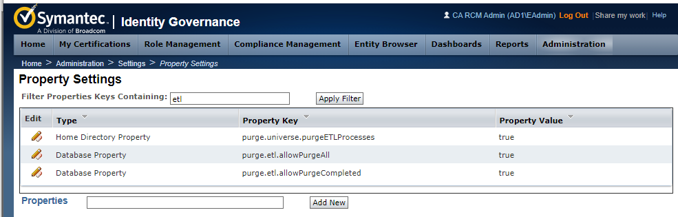

To remove the stuck ETL workflow and permit new processes to run, the system configuration must be modified to allow the purging of ETL tasks:
  1. Navigate to Home > Administration > Settings > Property Settings.
  2. Filter for the term etl to locate the relevant configuration settings.
  3. Modify the following three settings to true:
    • purge.etl.allowPurgeCompleted
    • purge.universe.purgeETLProcesses
    • purge.etl.allowPurgeAll
  4. Navigate to the Workflow list within the administration console.
  5. Locate the ETL workflow that is currently stuck in the 'created' state.
  6. Select the option to purge the identified workflow.
Once the stuck workflow is removed, the system will allow the initiation of a new ETL process.
