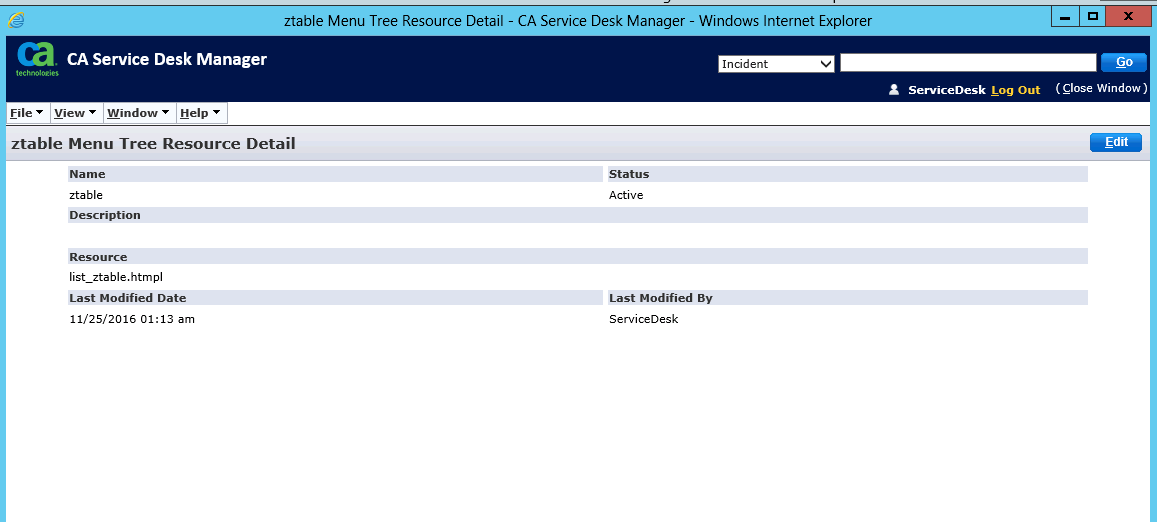

(2)In SDM: create a new menu tree resource detail:
Path: Security& Role management->Role Management-> Menu Tree Resources
Below screenshot: added a customized html form (list_ztable) at resources

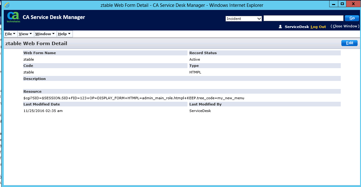

(4)Create new web form:
Under Path: Security& Role management->Role Management->web forms:
Resource: $cgi?SID=$SESSION.SID+FID=123+OP=DISPLAY_FORM+HTMPL=admin_main_role.htmpl+KEEP.tree_code=my_new_menu
In above line “my_new_menu”   is the name I have given to the MENU Tree I created. Replace it with your menu tree name

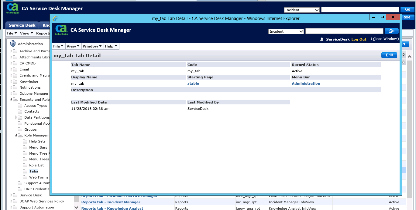

(5)Create new tab:
Under Path Security& Role management->Role Management-> Tab
In this window at “starting page” I gave web form name that I created in above step 4.

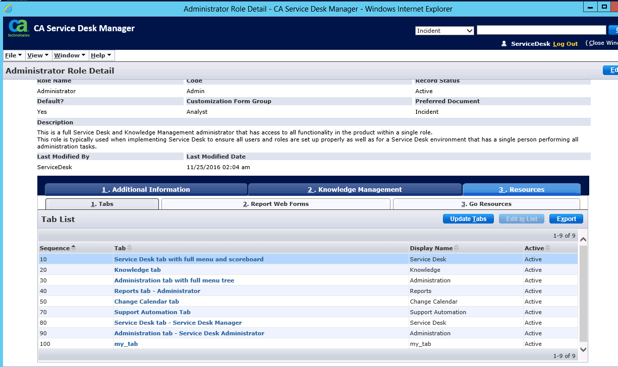

(6)Now Open the Role List:
Select which role you want.
Example Open Administrator Role: Go to Resources Tab and click on Update Tabs.
And select the Tab name you created in above step 5.

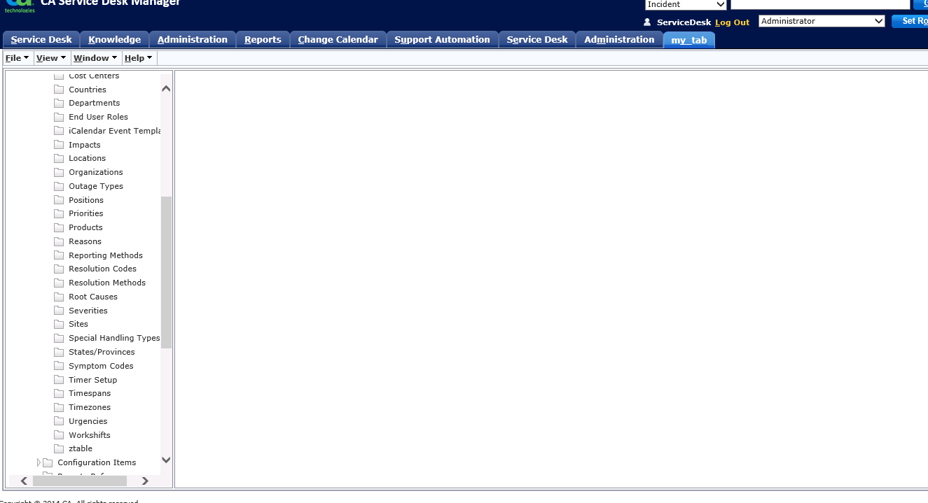

(8)Run “pdm_webcache -H” from command prompt and login into SDM.
You will see output as:
An extra Menu: my_tab will be added.
This will be an exact replica of Administration tab-> with added node.
