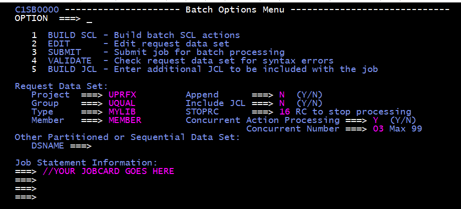

If you use Endevor ISPF to generate your batch job:
You can have Endevor automatically add the EN$CAPnn DD card. For example, on the batch options menu, displayed below, you can set Concurrent Action Processing to 'Y' and set the Concurrent Number (which defaults to SPAWNCNT) to a value less than or equal to the SPAWNMAX. The generated JCL will include the EN$CAPnn DD card.
