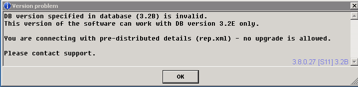

"DB version specified in database (3.2B) is invalid. This version of the software can work with DB version 3.2E only. You are connecting with pre-distributed details (rep.xml) - no upgrade is allowed. Please contact support."
If you are working with a pre-distributed rep.xml file that holds the repository credentials so you do not have to connect every time, and you perform an upgrade of the GTDatamaker GUI, you will essentially need to upgrade the repository too. In that case, you will have to first eliminate or re-name the already existing rep.xml file to proceed with the upgrade of the repository.

1. Launch Datamaker using the Desktop icon or through the file system (TDM_HOME\Grid-Tools\GTDatamaker\gtdatamaker.exe).
The following message appears:
This message means that you have to upgrade the repository before proceeding.
2. Navigate to the TDM_HOME\Grid-Tools\GTDatamaker directory, and rename the rep.xml file to rep-old.xml or delete the file.

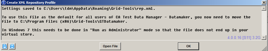

7. Click on the XML button which can be found on the top right hand side.
8. The following page will pop up.
9. Navigate to c:\users\tdm\AppData\Roaming\Grid-Tools and copy the rep.xml file to TDM_HOME\Grid-Tools\GTDatamaker directory.
