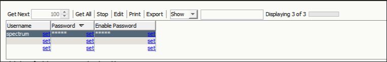

If you check the Device Family -> Information -> Device Configuration Transfer Settings tab you should have the following configured:

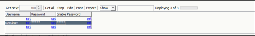

In order to resolve this issue, please clear the credentials out of the first row of the table and enter them into the second row of the table as follows:
Once this is set, please re-run the “Save to Startup Task” and it should now run successfully.

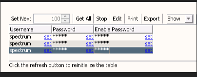

NOTE: By right-clicking the table columns and selecting "Sort" - this will rearrange the table and put the credentials back on line 1 and reproduce the issue. For a more stable workaround, try adding credentials to each line of the table. Thus even if the table is "sorted" there will always be credentials on line 2 which is the line that works.
