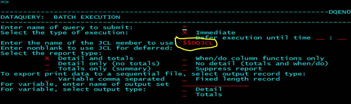

In order to determine which JCL member could be causing the problem, it is necessary to see the user's screen before they press the PF3 key for SUBMIT. The JCL member that is used would be shown on that page. Here is an example:
In this example, the JCL member used is $$DQJCL (the system default member). Any other user JCL member could be specified here instead. If the JCL member specified is the default, then a system administrator should be contacted to make the change; otherwise, any user can change their own JCL.
