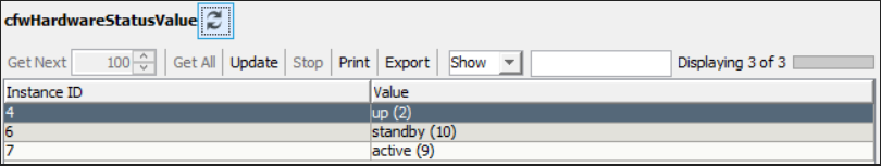

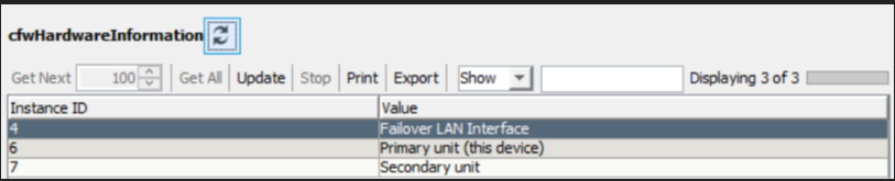

Basically Spectrum polls the following OIDs to check the hardware status of Cisco ASA devices.
You can find these OIDs from Locator--> Application models-->Search for "CiscoFirewallApp". You should be able to find CiscoFirewallApp application model for both Primary and Secondary ASA Firewall.
Below is a scenario to raise this "PRIMARY UNIT IS NOW STANDBY" alarm.
cfwHardwareInformation:
cfwHardwareStatusValue:
This means Primary unit is standby and Secondary unit is active. Once Spectrum defects Secondary is active and Primary is standby, a "PRIMARY UNIT IS NOW STANDBY" alarm would be inserted to the Primary Unit.
