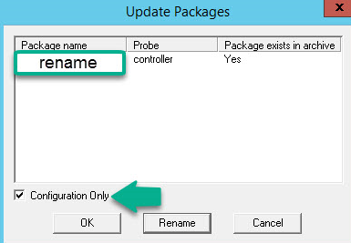

2- Locate the "controller" probe and drag it to the Archive.
    You will be prompted with  dialogue box.
3- Change to "Configuration Only" (if not already checked).
     Rename the package.

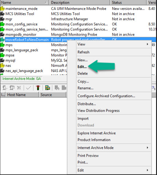

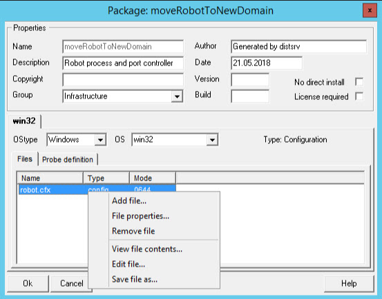

4- Locate the new package in the archive and "Edit"

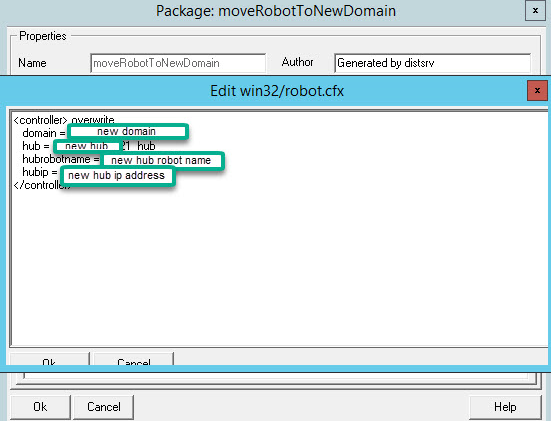

5- Edit the robot.cfx file
Replace the contents as shown below:
Be mindful of whether the original cfg file had hubdomainname, you may also need to include that.
Save the package.
