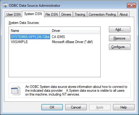

Change Data Source definitions to use protocol IDMS
To change your CA IDMS data source definitions to use the wire protocol, go into the ODBC Data Source Administrator application, click either the User DSN or System DSN tab as appropriate, and then click on the data source you wish to change.
<Please see attached file for image>
src="/servlet/servlet.FileDownload?file=0150c000004AJZrAAO" alt="pic1.jpg" width="471" height="390">
