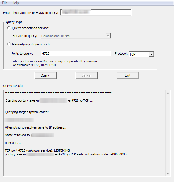

However, sometimes it is hard to determine what could be causing an issue with passing of TCP/UDP packets and requires more trouble shooting and this is where Microsoft’s PortQryUI comes into play.  This is a graphical utility from Microsoft that allows you to verify connectivity between two hosts (both UDP and TCP).
CA Client Automation - All Versions
- Download and install Microsoft PortQryUI
- Run portqueryui.exe

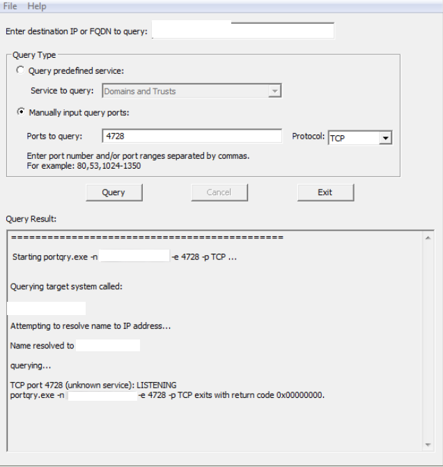

- This bring up the graphical interface as below where the destination can be tested using the IP address or the Hostname.
Use the option manual input query ports
Choose the desired protocol TCP or UDP depending on the port you are querying
You will see the result as shown below using port 4728 TCP as an example.
