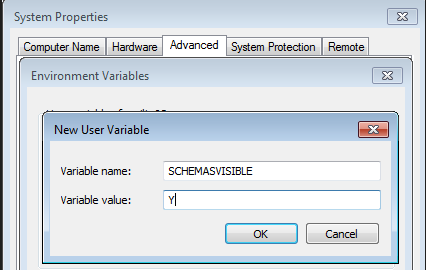

Option 3. Add an environment variable called SCHEMASVISIBLE
  • This option is only available to users with TDM release version 3.2.3 and above.
  • This option involves adding an Environment Variable on your Operating system and restarting your machine.
  • The steps below for this option are for adding an environment variable on a Windows machine.

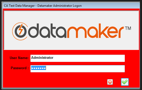

  2. On the login page, enter your User Name and Password. Then, click the green checkmark in the bottom, right-hand corner of the window or hit ‘Enter’ on your keyboard.
  3. Once inside Datamaker, on your keyboard, press Ctrl + Alt + M.
  4. A 'Datamaker Administrator Logon' window will pop up. Enter in your User Name of 'Administrator' and your corresponding Password. A 'Maintain Connections' window should now appear.

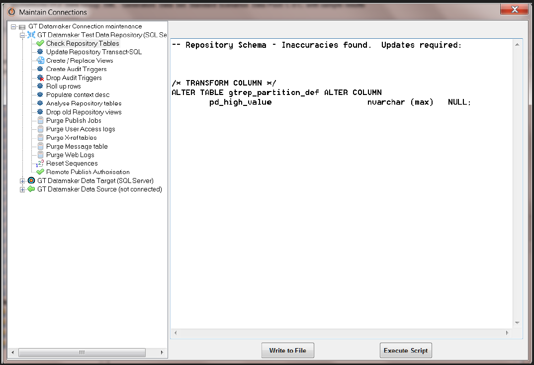

  5. Under 'CA Test Data Manager- Datamaker Connection Maintenance', click on the + sign next to 'CA Test Data Manager- Datamaker Test Data Repository' to expand the tree underneath it.
  6. Click on the 'Check Repository Tables' option with a green checkmark next to it.
  7. You will be prompted with the message 'Check all CA Test Data Manager- Datamaker tables are present in the repository connection. This facility will check if any tables are missing and create a script to create any missing tables. Click the Process button to check the tables.' Click on the 'Process' button.
  8. You should see a 'Checking repository tables' message' while it is running the check.
    - If everything is correct in your repository, you will get a message saying 'Repository Schema OK - No updates required.'
    - If updates are required, the script to correct the repository will be listed in the right-hand panel. You will click 'Execute Script' to perform the updates.
  9. Under this same tree, on the left-hand side, click on 'Update Repository Transact-SQL' with the blue gear icon next to it.
  10. You will get a pop-up message asking 'Do you want to update all the repository Transact-SQL?'. Click the 'Yes' button.
  11. You should get a message returned saying something similar to '9 attempted, 0 failed or not attempted'. Click the 'OK' button.
    - This verifies that your repository database is up-to-date and synced properly. Your repository maintenance is complete.

  10. A 'Datamaker Administrator Logon' window will pop up. Enter in your User Name of 'Administrator' and your corresponding Password. A 'Maintain Connections' window should now appear.
  11. Under 'CA Test Data Manager- Datamaker Connection Maintenance', click on the + sign next to 'CA Test Data Manager- Datamaker Test Data Repository' to expand the tree underneath it.
  12. Click on the 'Check Repository Tables' option with a green checkmark next to it.
  13. You will be prompted with the message 'Check all CA Test Data Manager- Datamaker tables are present in the repository connection. This facility will check if any tables are missing and create a script to create any missing tables. Click the Process button to check the tables.' Click the 'Process' button.
  14. You should see a 'Checking repository tables' message while it is running the check.
  15. Under this same tree, on the left-hand side, click on 'Update Repository Transact-SQL' with the blue gear icon next to it.
  16. You will get a pop-up message asking 'Do you want to update all the repository Transact-SQL?'. Click the 'Yes' button.
  17. You should get a message returned saying something similar to '9 attempted, 0 failed or not attempted'. Click the 'OK' button.
Option 3: Add an environment variable called SCHEMASVISIBLE
  1. From your Windows desktop, open the Start Menu.
  2. Right click on 'Computer' and select 'Properties' from the drop-down menu.
  3. In the left-hand side panel, click on 'Advanced system settings'.
  4. A 'System Properties' window will appear. Click on the 'Advanced' tab, if you are not already in it.
  5. Click on the 'Environment Variables' button.
  6. Click on the 'New...' button.
  7. In the 'New User Variable' window, enter the following information:
    - Variable name: SCHEMASVISIBLE
    - Variable value: Y
    - Click the 'OK' button once finished.
  8. You should now see the variable listed in the 'Environment Variables' table. Click the 'OK' button.
  9. You will be taken back to the 'System Properties' window. Click the 'OK' button.
  10. Now you will need to restart your computer.

  15. A 'Datamaker Administrator Logon' window will pop up. Enter in your User Name of 'Administrator' and your corresponding Password. A 'Maintain Connections' window should now appear.
  16. Under 'CA Test Data Manager- Datamaker Connection Maintenance', click on the + sign next to 'CA Test Data Manager- Datamaker Test Data Repository' to expand the tree underneath it.
  17. Click on the 'Check Repository Tables' option with a green checkmark next to it.
  18. You will be prompted with the message 'Check all CA Test Data Manager- Datamaker tables are present in the repository connection. This facility will check if any tables are missing and create a script to create any missing tables. Click the Process button to check the tables.' Click the 'Process' button.
  19. You should see a 'Checking repository tables' message' while it is running the check.
  20. Under this same tree, on the left-hand side, click on 'Update Repository Transact-SQL' with the blue gear icon next to it.
  21. You will get a pop-up message asking 'Do you want to update all the repository Transact-SQL?'. Click the 'Yes' button.
  22. You should get a message returned saying something similar to '9 attempted, 0 failed or not attempted'. Click the 'OK' button.
  10. Under this same tree, on the left-hand side, click on 'Update Repository Transact-SQL' with the blue gear icon next to it.
  11. You will get a pop-up message asking 'Do you want to update all the repository Transact-SQL?'. Click the 'Yes' button.
  12. You should get a message returned saying something similar to '9 attempted, 0 failed or not attempted'. Click the 'OK' button.
