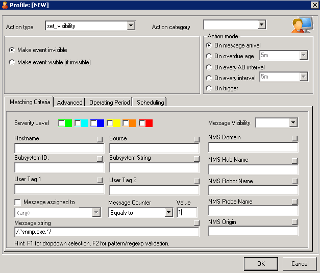

Nas AO profile 1:
Action type: set_visibility
Make event invisible
Action mode: On message arrival
Message string: /.*<process_name>.*/
Message Counter: Equals to 1
