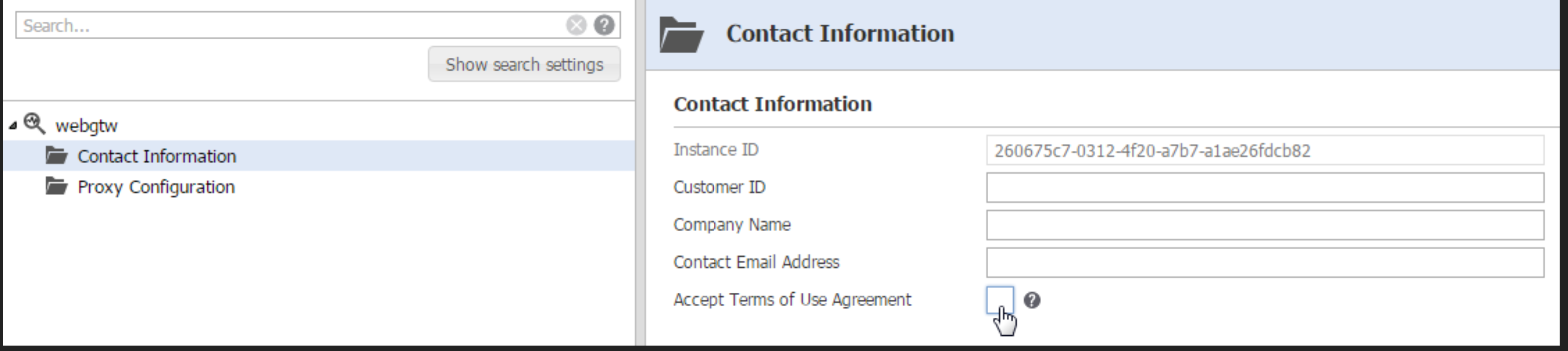

  • Click on Contact Information and verify that you have filled out the information and accepted the terms of use agreement

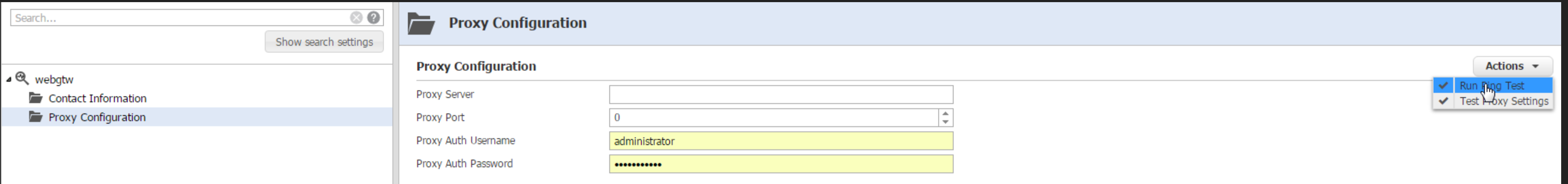

  • Click on Proxy Configuration. Select Actions on the top left and Run Ping Test to verify that the ping is successful.  If the ping is not successful, please consult the Additional Information section for troubleshooting open ports and addresses.
  • Verify that the Proxy Configuration is set up correctly.  You can also Test Proxy Settings as noted in the image above.
