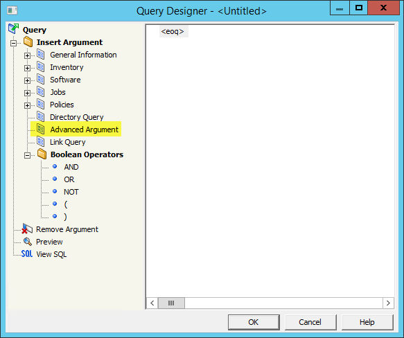

Step 1: Create a new query for Computers:
Step 2: Choose "Advanced Argument" from the query designer:
Step 3: Fill in the advanced argument details:
Pseudo text
Enter text to identify what the query does. This is only a label field, and helpful on the previous screen for managing multiple arguments of your DSM query.
Table:

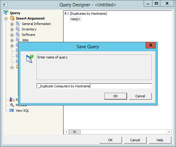

Be sure to change to "-Any-".  As the query we are importing intends to return a list of computers, this informs DSM to expect a dis_hw_uuid (or equivalent) as the return from your custom query.
Additional WHERE clause:
This is where you provide your custom query, which returns the dis_hw_uuid field back to DSM.
Important Note: Your query must be formatted without any carriage returns or line breaks.

Step 4: Preview query results, and save.
Step 5: Repeat the process if you wish to add more of the sample queries for identifying duplicate computers.
Step 6: Create a new dynamic groups for each query.
