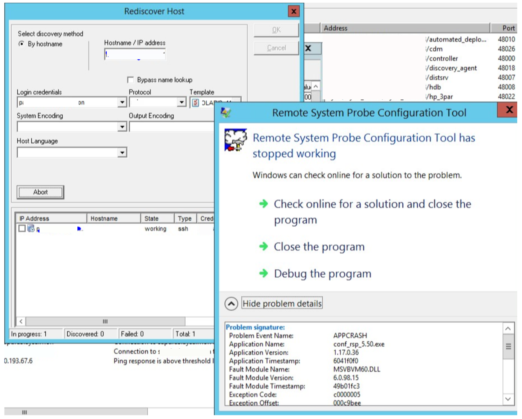

The discovery profile in the rsp probe (wmi protocol is used), sometimes causes the crash of the probe.
Details of the crash:
Problem signature:
Problem Event Name: APPCRASH
Application Name: conf_rsp_5.30.exe
Application Version: 1.17.0.36
Application Timestamp: 59b90dde
Fault Module Name: MSVBVM60.DLL
Fault Module Version: 6.0.98.15
Fault Module Timestamp: 4a5bda6c
Exception Code: c0000005
Exception Offset: 000c9bee
OS Version: 6.1.7601.2.1.0.272.7
Locale ID: 2057
Additional Information 1: 0a9e
Additional Information 2: 0a9e372d3b4ad19135b953a78882e789
Additional Information 3: 0a9e
Additional Information 4: 0a9e372d3b4ad19135b953a78882e789
