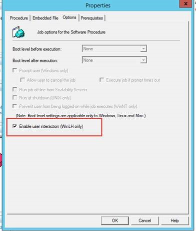

When the Software Delivery Item Procedure or Job Option for Enabling User Interaction is selected it will only run scripts in a 32-bit mode which may cause the script to have an unexpected outcome depending on what it attempts to access or accomplish.
This document describes how you can use DMS scripting, to launch a script interpreter in 64-bit mode, to achieve the desired results.
