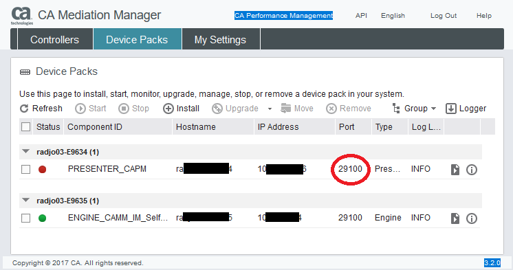

The Delivery Service on the Local Controller the Engine is on sends a request through the LocalController to the MultiController to locate the IP address and TCP port of the Presenter.
The Delivery Service must be able to contact the Presenter on that address/TCP port.
The port can be seen in the CAMM UI :
CAMM UI showing Presenter port value and location
