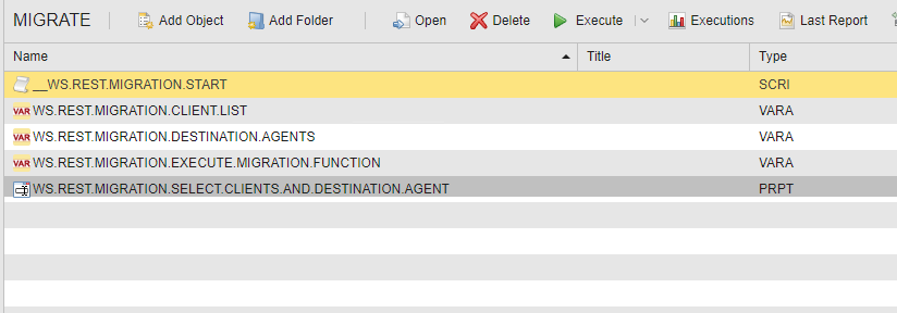

1. Loaded - WEBSERVICE_REST_MIGRATION.TXT with DBLoad Utility.
2. Imported uc4_export_migration.xml in User Interface
3. And when I run the migration script script __WS.REST.MIGRATION.START, the progress failed with these error messages:

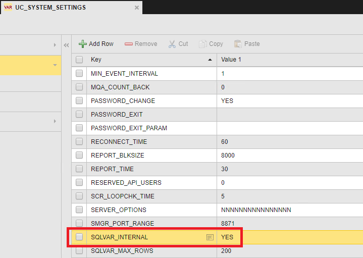

2. In client 0, go to UC_SYSTEM_SETTINGS and change the value of SQLVAR_INTERNAL to YES.

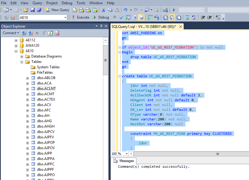

3. Manually execute the content SQL statement of webservice_rest_migration.sql in Microsoft SQL Management Studio. Check the WEBSERVICE_REST_MIGRATION.TXT to find the suitable file with your DB.

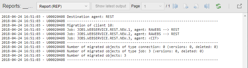

4. Turn off the old RA-Webservice agent, keep the new RA-Webservice-REST agent running, and then execute the script __WS.REST.MIGRATION.START again.
5. When the script is successfully performed, it should have report messages like this:
