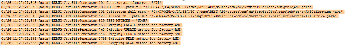

If advanced logging is enabled on REST by following the process at this link prior to running pdm_rest_util -deploy, the file nx_root\log\jrest.log contains lines stating "REST METHODS = 'NONE'", "Skipping CREATE method", "Skipping UPDATE method", and "Skipping READ method" for every factory except for "rest_access". Some factories may show additional errors about "Unsupported (dotted attribute)". These errors look like the highlighted lines in the following image:

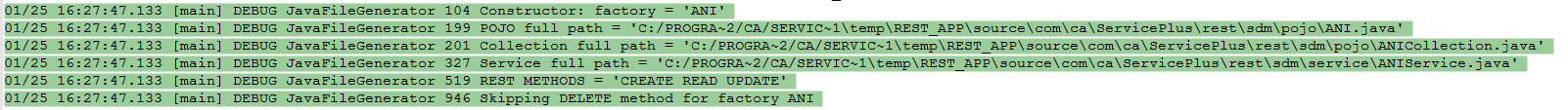

After this issue has been resolved, caisd-rest.war should be approximately 4.5MB in size, and REST calls should function as normal. If you have it enabled, debug-level logging on jrest.log should look like the highlighted lines in the following image:
Note: For most factories, it's okay and expected to have the line "Skipping DELETE method", as deleting items is generally unsupported across Service Desk Manager as a whole.
