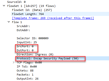

You can verify this in wireshark by capturing the Netflow data from a device on the Harvester by following the steps in this KB  How can I determine if a NetFlow enabled device is sending the correct fields and data using WireShark?
Then Look for flows with "Protocol: Encap Security Payload (50)" like in the screenshot below and you will notice that the SrcPort and DstPort are both 0:
This is a Netflow limitation on the device, you can check with your vendor to see if there is a configuration that will allow for IPSEC traffic to show the actual ports in the netlfow data it exports.
