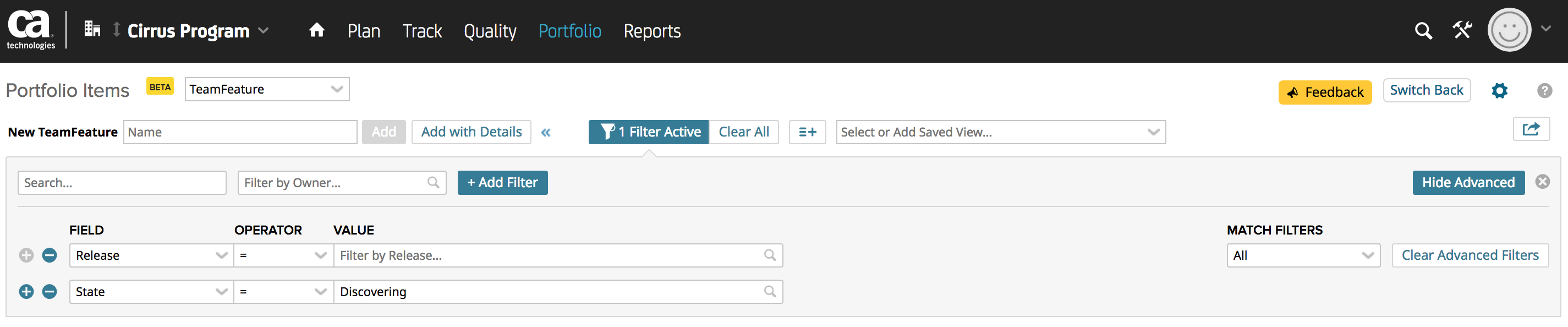

This is the View which was created for the project showing up in the Project Scope :
As you can see the Release value is kept.
And this is the situation where the same View has been chosen in a different project :
The view hasn't been actually chosen and the Release value has been removed.
In order to use the same view (with the same filters/columns setup/etc.) under a different project, you will need to create a new view for each project and once such view is created it’s easy to modify and re-save:
As you can see it's a different project and now the Release retains the value correctly since the separate view has been created for this very project.
