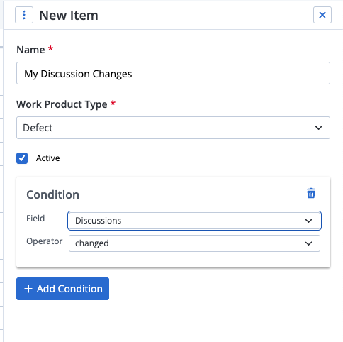

Once email notifications are set up, you can set up a Notification Rule.
Click the down arrow which is right to your avatar -> My Settings -> Notification Rules.
Select your Work Product Type from the drop-down, you can choose between Defect, Defect Suite, User Story, Task and Test Case. Then, under the Actions link on the right hand side, click "New Notification Rule":
In the Condition section, select the Discussions field and select "Changed" operator.
This means that every time the Discussions field will change, which a new discussion is added, or a discussion is amended then the notification rule will fire and the email will be sent.
