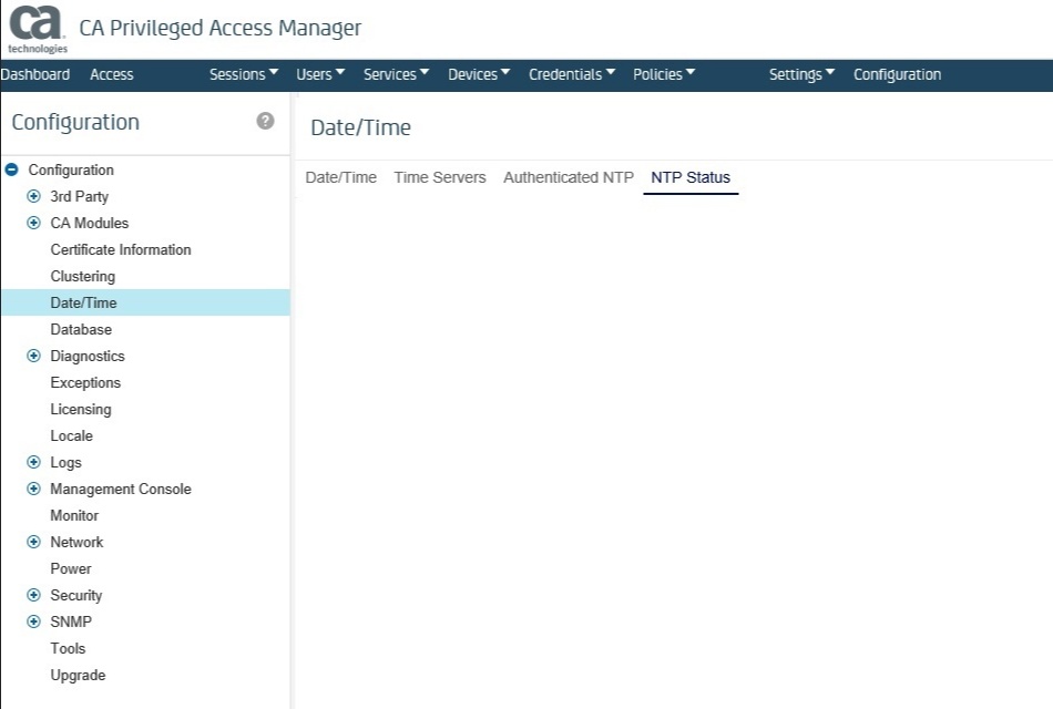

The NTP status is blank.
The status tab was able to display the details of the NTP but unsure what has changed, the NTP Status page now does not display NTP related information at all and the NTP Status tab is a blank page.
Even a refresh does not show the NTP Status
Reboot the appliance but the issue still persists.
