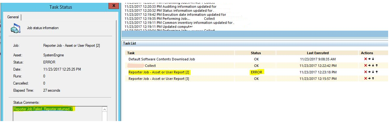

One or more scheduled report jobs linked to an Engine are in status ERROR with following status comments :
Reporter Job Failed. Reporter returned:7
In DSM\logs\TRC_REPORTER_*.log following error could be found :
ERROR  | Error calling Reporter interface [#7]

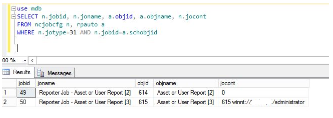

With Microsoft SQL Server Management Studio, execute following SQL request to check all Scheduled Report Engine jobs :
use mdb
SELECT n.jobid, n.joname, a.objid, a.objname, n.jocont
FROM ncjobcfg n, rpauto a
WHERE n.jotype=31 AND n.jobid=a.schobjid
In this example "Reporter Job - Asset or User Report [3]" is correct as objid 615 is present in jocont column.
But "Reporter Job - Asset or User Report [2]" is not correct because jocont contains the string 0 (instead 614) :
All Scheduled Report Engine jobs with jocont=0 are not correct.
