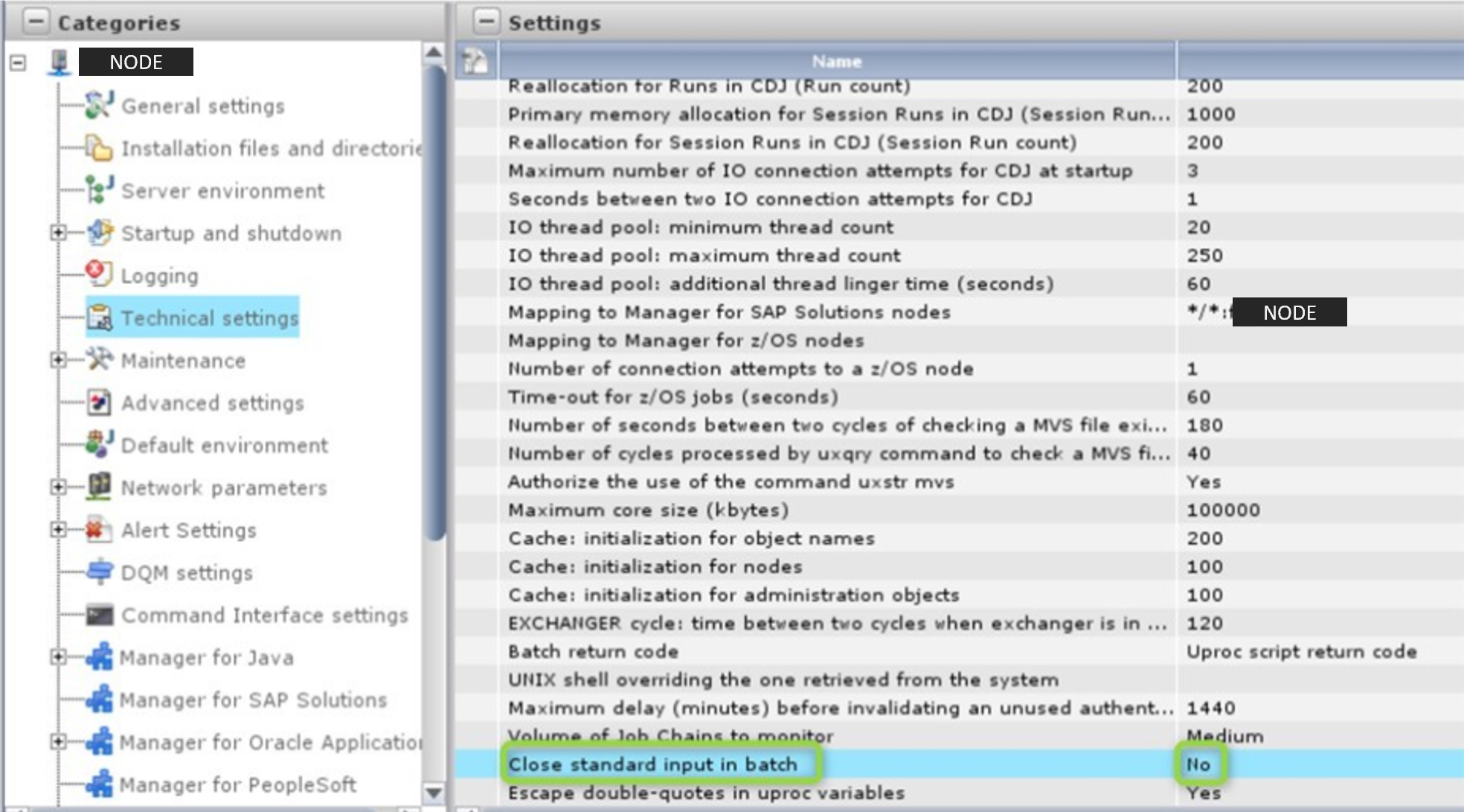

By default, Dollar Universe 6 closes the stdin of the launched processes and until version 6.4.01 this setting could not be modified.
First, be sure that the Dollar Universe node is on version 6.4.01 or superior.
There is a new node setting on Dollar Universe for Unix:U_BATCH_CLOSE_STDIN which is set by default to Y.
You can find it on the section Technical Settings -> Close standard input in batch
In case your scripts are failing because of this issue. specially on Linux/Unix with bash / ksh shells, it will be necessary to set this variable to No (N).
