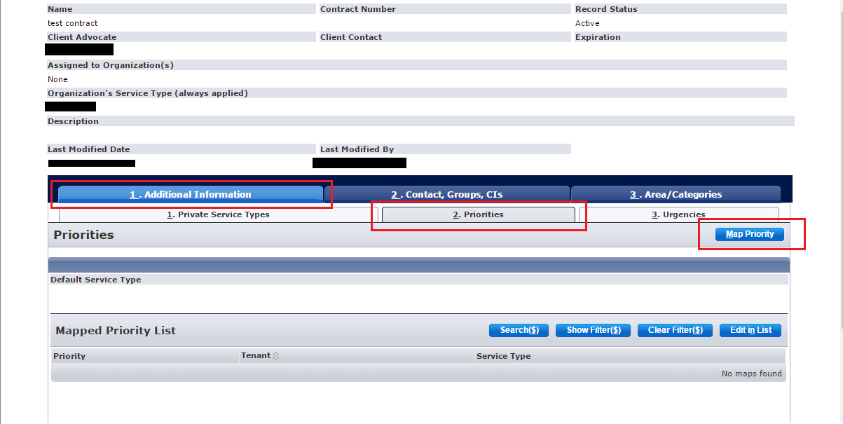

A Service Contract needs a Private Service Type, that is mapped to a Priority, in order for the Service Type to be automatically attached to the ticket.
Within the Service Contract select the Additional Information tab, then the Priorities tab.
Select Map Priority, then select the Private Service Type mapped to the Service Contract.
Now the Service Type should be automatically attached to the ticket.
