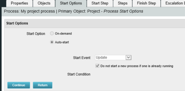

5. Find below screenshot on what the auto-start condition looks like

9. Go back to the process we created and go to the "Start options" tab
Expected results: The auto-start condition to display as it was set
Actual results: The auto-start condition has vanished and is blank.
Any CA PPM release
The auto-start condition defined at the process level is not valid any longer
This is the expected behavior: The Auto-Start condition that was initially set is not valid any longer
Please reactivate the inactivated lookup or recreate a new valid auto-start condition
