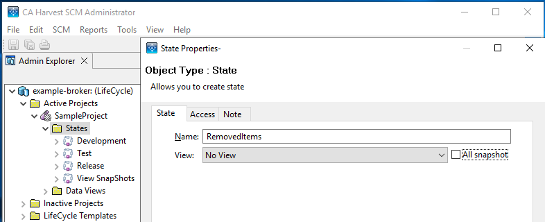

  1. (if you want to remove, but “keep” the file) In Administrator Tool, create a new state to hold all versions of the item after it has been removed.  You should configure this new state to not have an associated data view.

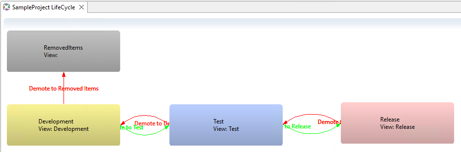

  1. In Administrator Tool, ensure you have configured promote and demote processes that sequentially pass through every state, both going up and coming down.  Include a “Demote” process from your first state to the new state created in Step 1.  Also ensure that every state has a “Switch Package” process.  To get a graphical representation of your states and the promote/demote paths available, you can right click on the project name and select “View Project Lifecycle”.
